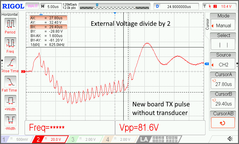

One downside of this solution is that I had to change a generated file within the auto-generated section so it will break if I regenerate the code from the .ioc file. The resulting waveform (from the transducer side of the transformer) is below.
