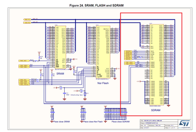

You can refer to the STM32H743-EVAL schematics:
It contains a 32-bit SDRAM.

But as @mƎALLEm indicates the H750 is the same IC as the H743/H753 just with the lower 128KB of FLASH tested and the CRYP/HASH unit enabled.
The EVAL board probably the primary example. I think there's a RIVERDI H7 board with an 8 MB (64Mb) 32-bit wide data bus, but the schematic didn't immediately pop up.
