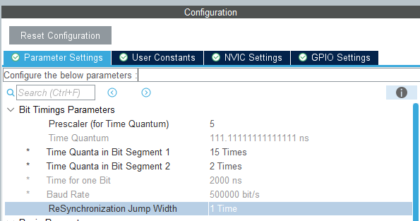

I used CubeMX to configure the CAN, and the ioc file is attached. I did a lot of searching online, and someone did mention that this might be a problem with SJW and Time Seg, although the SJW and Time Seg I configured were able to get the correct baud rate after calculation. Perhaps I should try other SJW or Time Seg values?

Your time seg 1 and 2 are pretty close to each other. The sampling point should be in the high 80s
Your values might be closer to ~30
try these values

Good news, I tried to recreate a new project, where only CAN1 and USART1 (for sending debug data) were enabled, and it seems that the STM32 can normally and stably receive the data returned from the host computer.
In my original project with LVGL integrated, CAN could not be received normally even after trying the new sampling point. There must be something in my code that prevents CAN from running normally.
