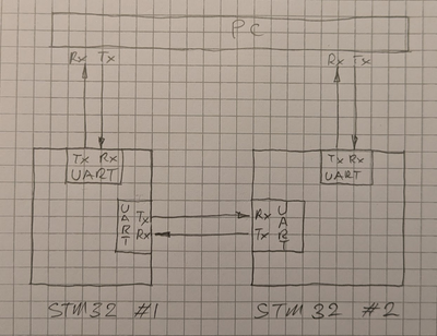

I want to create sort of application that transmit and receive messages between 2 STM32F407 DISC0 and echo the transmited and received messages in PC screen(sort of chatbox)
any hints how can I do it?
and is it easier using USART or SPI?

Of course, transmitting and receiving messages is exactly what UARTs are for!
You will need:
PS:
@avatar_ang wrote:and is it easier using USART or SPI?
That depends on how familiar you are with SPI...
Connecting to a PC is certainly easier via UART.

The simplest PC side would use UART to USB adapter cables and either two Terminal programs in the PC or one terminal program in each of two PCs.

@Hal3 wrote:The simplest PC side would use UART to USB adapter cables
Simpler still: the VCPs in the ST-Links on the Disco boards.
Except that @avatar_ang seems to be using STM32F407G-DISC1 - where the VCP is not connected.
@avatar_ang if you're specifically wanting to do UART comms with PCs, it would make a lot more sense to choose a different board which does have a working VCP.
eg, NUCLEO-F411RE if you want to keep in the F4 family ...
2026-02-23 8:26 AM
If the Chat application will be ultimately on a custom board and requires one PC with one connection, connect the two processors with a 485 bus using uart to 485 transceivers and connect the PC with a 485 to USB adapter. That will minimize ground problems and easily expand to more processors.
