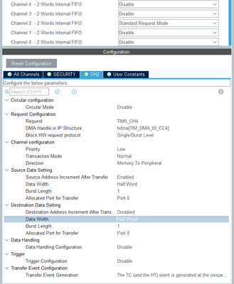

This is GPDMA configuration:

Hello @m4rk0401,
In your GPDMA configuration, in the destination data setting, try enabling the destination address increment after transfer

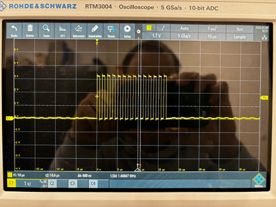

Unfortunately is set 24 different duty cycles in my code and get following result using a oscilloscope:
Any idea why only 14 cycles are outputted?

We had a similiar error with GPDMA. What helped us, was changing Data width to "Byte" in Source data setting and destination data setting in GPDMA configuration. Also then you have to change
uint16_t pwmData[24];
to
uint8_t pwmData[24]
