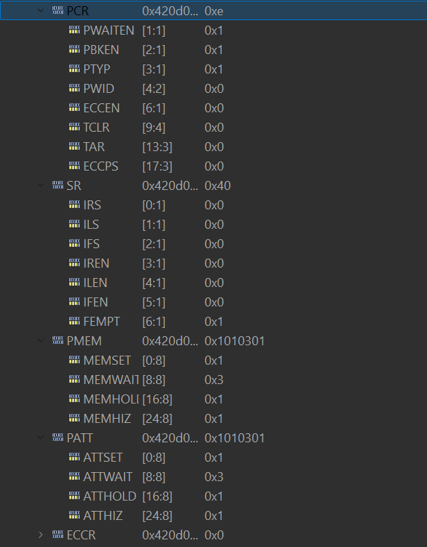

FMC NAND SFRs in STM32IDE:

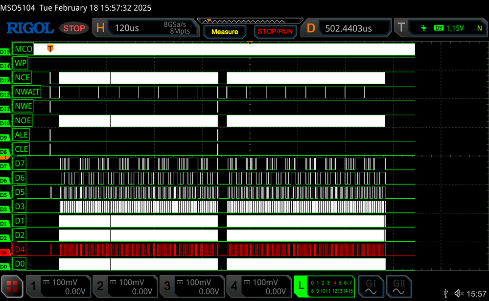

Logic Analyser on read transactions:
Logic Analyser display of 2 2k Page reads from NAND Flash chip

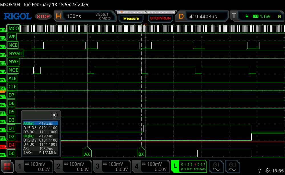

Zoomed in NAND Flash read, showing 200 ns in between reads
