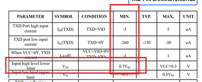

Another remark. I'm not sure which versions of the transceiver you have on the board? the VIO pin version? if not, the transceiver seems to be not suitable as VIHmin = 3.5V > VDD:
