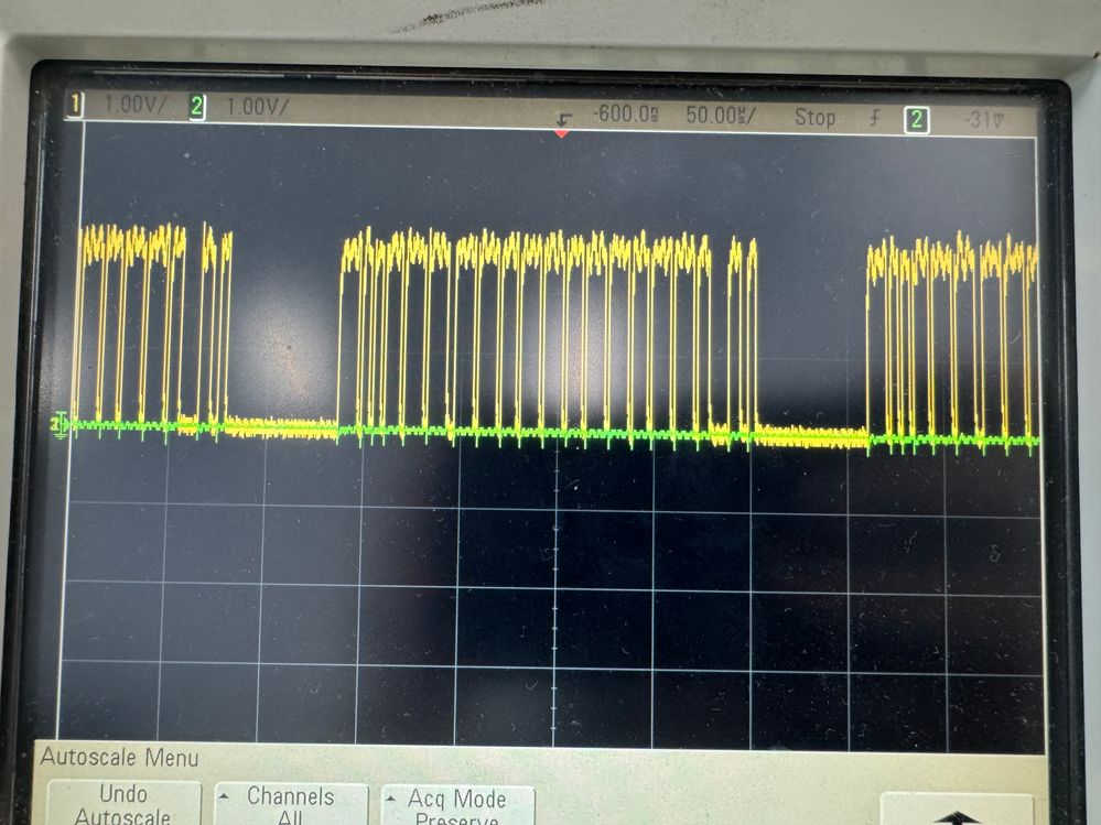

Sorry I didn't make it clear. The X and Y I mentioned are actually channels 1 and 2. When testing, since my CAN cable did not lead out GND, I simply connected CANH to channel 1 and CANL to channel 2. The oscilloscope probe was not connected to anything else.
Speaking of this, I do think the signal returned by my oscilloscope is a bit strange. I think the CAN bus should be a differential signal, but the actual signal is very strange...

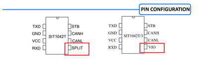

1- Probe the Rx pin from SIT1042.
2- Check if you have the VIO pin version of the transceiver:
Not related directly to the reception but it will be a problem to send the acknowledgement bit after reception.

2025-02-24 11:26 PM - edited 2025-02-24 11:28 PM
@most1ma wrote:Sorry I didn't make it clear. The X and Y I mentioned are actually channels 1 and 2. When testing, since my CAN cable did not lead out GND, I simply connected CANH to channel 1 and CANL to channel 2. The oscilloscope probe was not connected to anything else.
You don't have a signal on channel 2. So it's a hardware/wiring issue. Without both differential signals present, you won't get any signal going to the CAN Rx of the STM32.
Also, other than the PC and STM32, are there any other CAN nodes connected?

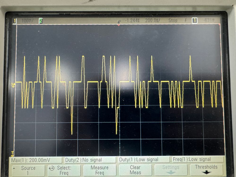

1. Oscilloscope results of Rx pin:
2. It has the VIO pin

Rx signal should not go below ground reference. Do you have a ground reference between the PC and the STM32? What are you using on the PC side to communicate?
2025-02-25 12:20 AM - edited 2025-02-25 12:21 AM
@most1ma wrote:
These are weird signals. It should be a hardware issue.

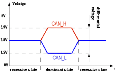

And according to your CAN_H and CAN_L signals they are weird too. CAN_H and CAN_L are not supposed to reach the GND. Also your CAN_L is always 0!
This is what you need to see on CAN_H and CAN_L.
Check again your connections, especially the jumpers related to the USB. Check CAN_H and CAN_L connections using the continuity in the multimeter. Not obvious to tell what is going on.
