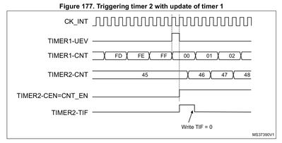

Then I read in the manual, that I need to "Write TIF = 0" and this is where I am stuck.
My understanding of "Write TIF = 0" is that I need to reset the status register:
TIMx->SR = ~TIM_FLAG_Trigger;
But that does not seem to be enough to "arm" the timers again.

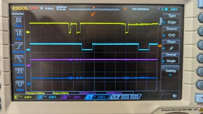

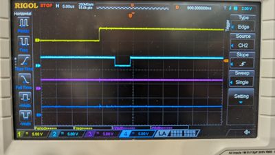

That is what I am trying to do. I can trigger Timer 2 via ETRF:
(yellow is my signal via ETRF and cyan is TIM2)
and I can also do this multiple times:

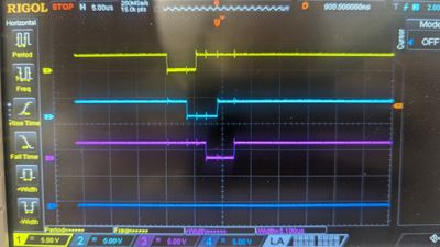

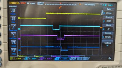

I am also able to trigger the cascade once:
(yellow: ETRF, cyan: TIM2, pink: TIM1, blue: TIM3)
But after I triggered the cascade once, I can not do this again, but instead the result looks like in figure 1 and 2.

My understanding is that the TIF bit in the status register of the respective timer gets set to high when the selected ITRx source is getting fired. I have set e.g. for TIM1
TIM_SelectInputTrigger(TIM1, TIM_TS_ITR1); which sets the SMCR register.
And then I need to reset the TIF bit in the status register.
But setting TIMx->SR = 0; does not do the job.
So I figured I need to do some preliminary steps or followup steps to write to the status register or make the timer load the status register.
But here I do not know what to do, so any help would be appreciated.
