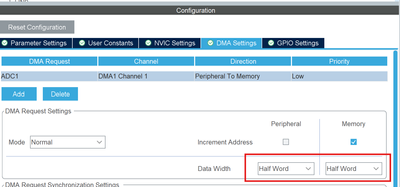

I've attached a screenshot of the ADC1 channel/rank configuration from STM32CubeMX.
I followed a tutorial for setting up ADC with DMA, and the configuration seems correct. However, when I debug the code, I noticed that the DMA buffer doesn’t get updated correctly when it’s declared as uint16_t (as shown in the second screenshot), despite casting the buffer to uint32_t.
I tried declaring the buffer as uint32_t adcBuffer[8], and that actually fixed the problem. Oddly, I’ve used the same code on an STM32F4 Discovery with similar ADC configuration, and it worked perfectly with a uint16_t buffer.
Screenshot showing buffer output on STM32G0:
Why does the buffer work only with uint32_t on the STM32G070 but not with uint16_t, even though the ADC resolution is 12 bits?
Am I missing something specific to the STM32G0 DMA behavior or alignment rules?

2025-07-22 12:17 PM
Set the DMA transfer size to a half-word.
If that's not it, please include your IOC file.
2025-07-22 12:17 PM
2025-07-23 2:37 AM
Thanks for your reply, changing the DMA memory data size to half-word did solve the issue on the STM32G070!
What still confuses me, though, is why the same code with a uint16_t buffer worked fine on my STM32F4 Discovery, even though the DMA memory alignment was set to word.
Is this behavior due to architectural differences between STM32G0 and STM32F4 (e.g., DMA handling, bus width, or alignment rules)? Or was the F4 case just "accidentally working" but not technically correct?
I'd love to better understand the underlying reason for this difference so I can avoid similar bugs in the future.
Thanks again for your help!
2025-07-23 6:00 AM
It will have the same effect on the F4. My guess is if you went back and checked, you would find some other reason to explain this.
