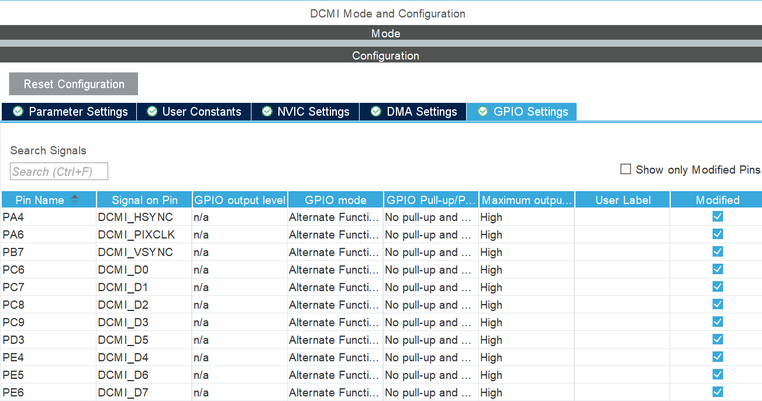

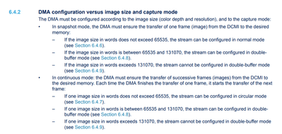

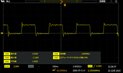

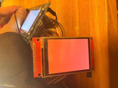

I am currently working on interfacing an OV7670 camera with an STM32F429 using DCMI + DMA, and displaying the captured image on an ILI9341 LCD (SPI interface).
I have successfully confirmed that the LCD itself works correctly (for example, filling the screen with a solid red color).
However, no camera image is displayed, so I suspect there may be an issue with the camera operation or the DCMI configuration.
I am using the following repository as a reference:
https://github.com/PHANzgz/STM32-H7-camera-interface-and-display
Since this project is originally for STM32H7, I have modified the configuration as much as possible to make it suitable for STM32F429.
At this point, I would like to ask whether there are any STM32F4-specific considerations, missing settings, or common pitfalls when using OV7670 with DCMI + DMA.
Any advice or working references for OV7670 + STM32F429 would be greatly appreciated.

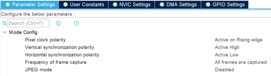

hdcmi.Instance = DCMI;
hdcmi.Init.SynchroMode = DCMI_SYNCHRO_HARDWARE;
hdcmi.Init.PCKPolarity = DCMI_PCKPOLARITY_RISING;
hdcmi.Init.VSPolarity = DCMI_VSPOLARITY_HIGH;
hdcmi.Init.HSPolarity = DCMI_HSPOLARITY_LOW;
hdcmi.Init.CaptureRate = DCMI_CR_ALL_FRAME;
hdcmi.Init.ExtendedDataMode = DCMI_EXTEND_DATA_8B;
hdcmi.Init.JPEGMode = DCMI_JPEG_DISABLE;
if (HAL_DCMI_Init(&hdcmi) != HAL_OK)
Error_Handler();

htim3.Instance = TIM3;
htim3.Init.Prescaler = 0;
htim3.Init.CounterMode = TIM_COUNTERMODE_UP;
htim3.Init.Period = 7;
htim3.Init.ClockDivision = TIM_CLOCKDIVISION_DIV1;
htim3.Init.AutoReloadPreload = TIM_AUTORELOAD_PRELOAD_DISABLE;
if (HAL_TIM_Base_Init(&htim3) != HAL_OK)
Error_Handler();
sClockSourceConfig.ClockSource = TIM_CLOCKSOURCE_INTERNAL;
if (HAL_TIM_ConfigClockSource(&htim3, &sClockSourceConfig) != HAL_OK)
Error_Handler();
if (HAL_TIM_PWM_Init(&htim3) != HAL_OK)
Error_Handler();
sMasterConfig.MasterOutputTrigger = TIM_TRGO_RESET;
if (HAL_TIMEx_MasterConfigSynchronization(&htim3, &sMasterConfig) != HAL_OK)
Error_Handler();
sConfigOC.OCMode = TIM_OCMODE_PWM1;
sConfigOC.Pulse = 0;
sConfigOC.OCPolarity = TIM_OCPOLARITY_HIGH;
sConfigOC.OCFastMode = TIM_OCFAST_DISABLE;
if (HAL_TIM_PWM_ConfigChannel(&htim3, &sConfigOC, TIM_CHANNEL_3) != HAL_OK)
Error_Handler();

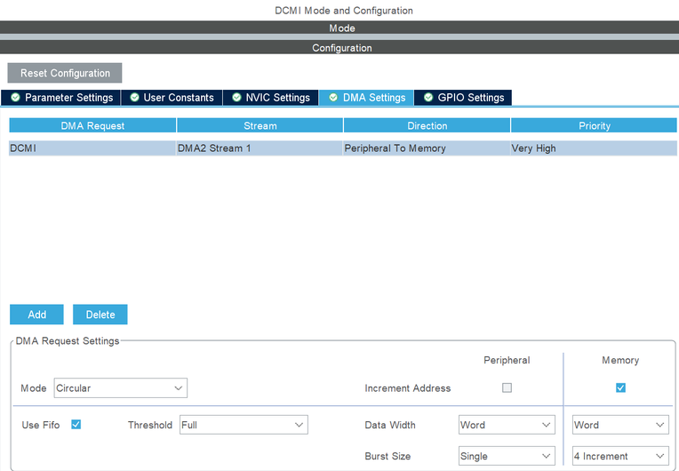

* Enable DMA controller clock
static void MX_DMA_Init(void)
/* DMA controller clock enable */
__HAL_RCC_DMA2_CLK_ENABLE();
/* DMA interrupt init */
/* DMA2_Stream1_IRQn interrupt configuration */
HAL_NVIC_SetPriority(DMA2_Stream1_IRQn, 5, 0);
HAL_NVIC_EnableIRQ(DMA2_Stream1_IRQn);

Fig.1 LCD with red color
Thank you.

My implementation is based on "STM32-H7-camera-interface-and-display".
I tested both single-frame and continuous capture modes.
Single-frame capture works, but continuous capture does not keep running.
I suspect that this approach may have limitations on the STM32F429I-DISCO board.
URL:https://github.com/PHANzgz/STM32-H7-camera-interface-and-display
htim3.Init.Period = 3;
Error_Handler();
Error_Handler();
Error_Handler();
Error_Handler();
sConfigOC.Pulse = 2;
Error_Handler();
HAL_NVIC_SetPriority(DMA2_Stream1_IRQn, 0, 0);

DCMI_HandleTypeDef hdcmi;
DMA_HandleTypeDef hdma_dcmi;
I2C_HandleTypeDef hi2c1;
Error_Handler();

TIM_ClockConfigTypeDef sClockSourceConfig = {0};
TIM_MasterConfigTypeDef sMasterConfig = {0};
TIM_OC_InitTypeDef sConfigOC = {0};
/* USER CODE BEGIN TIM3_Init 1 */
/* USER CODE END TIM3_Init 1 */
Error_Handler();
Error_Handler();
Error_Handler();
Error_Handler();
Error_Handler();
/* USER CODE BEGIN TIM3_Init 2 */
/* USER CODE END TIM3_Init 2 */
HAL_TIM_MspPostInit(&htim3);

Hello @chachamaru;
Are you using ST board? If yes could you please share the reference?
What are the configured GPIO settings?

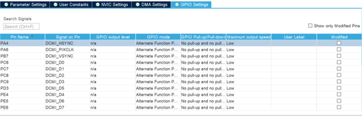

These are DCMI setting.
>Could you please check if the CAPTURE bit in DCMI_Cr register is enabled?
➡Yes
2025-12-15 6:07 AM - edited 2025-12-15 6:08 AM
Hello @chachamaru ;

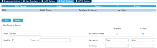

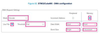

The DMA must be configured according to the image size (color depth and resolution) and to capture mode.
I recommend you to refer to AN5020 and check the DMA configuration requirements.
May be, you need to change the DMA mode from normal to circular?
Please check the maximum output speed?
Thank you.

2025-12-16 1:28 AM
Thank you for replying.
I checked DMA setting on DCMI.
I coudn't change GPIO output level.

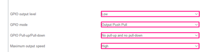

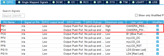

2025-12-16 2:07 AM

What is the image size (resolution and color depth)?
Is your issue solved by using DMA circular mode?
->I coudn't change GPIO output level.
I have recommended that you check the “maximum output speed.”
The shared image corresponded to GPIO_output pin configuration for a camera power pin.
I advise to look at AN5020 section 8.3 DCMI examples based on STM32CubeMX may help you.
No. I tried DMA circular mode, but the issue remains unchanged.
I checked AN5020, especially section 8.3 (DCMI examples based on STM32CubeMX), and my current configuration matches the settings described there.
However I still can't solve the issue.

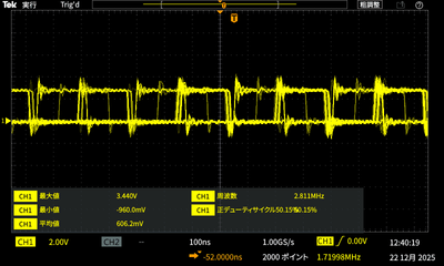

2025-12-19 7:04 AM
Hello @chachamaru ;
Could you check the waveforms of the DCMI signals using an oscilloscope?
Thank you.
Kaouthar
2025-12-21 7:31 PM
I chacked the waveforms of DCMI signals.
Fig.1 DCMI_D7 signal
Fig.2 DCMI_D7 Single waveform signal
