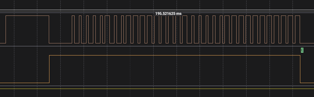

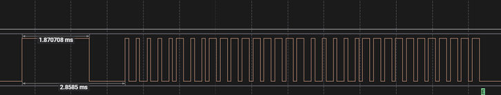

Hi, I tried to read signal from ultrasonic parking unit by capturing PWM input. Signal has one start pulse 530 Hz width (1.87 ms) and a sequence with 0 and 1 (9.942 kHz and 4,97 kHz) period between pulses sequences is about 193 ms.

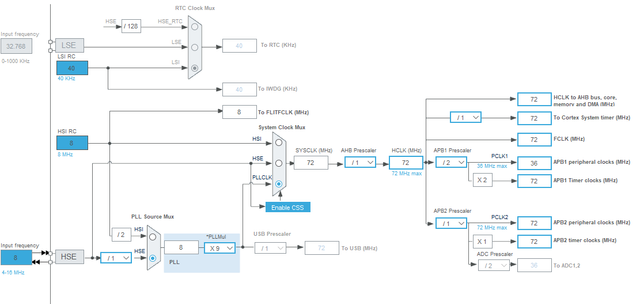

I use STM32F103 blue pill board with external 8Mhz quartz oscillator.
My clock config:

Main problem is to catch start pulse on this config. To work as expected I used to reduce width of start pulse from 530 Hz to 19 kHz to be able to catch it. For example, using timer on black pill STM32F4 with 32 bit AutoRload Register start pulse was captured with 530 Hz.

If I correctly understand that first pulse tried to capture 2 times because of its width 1.87 ms, as timer capture period is about 0.9 ms (Counter_Period / F clock -> 65535 / 72 Mhz = 0.9 ms).
