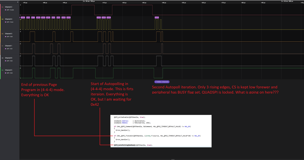

I am having an issue with autopolling too. I tried a lot of combinations of modes (1/4 Instruction lines, 1/4 Address lines, 1/4 Data lines). For me it seems there is a problem at least with (4-4-4) mode with autopolling. It looks it works fine in (1-1-1) mode or (1-4-4) mode. I connected it to analyzer and the results are quite strange.

I recall looking at the library source for the HAL QSPI, it has an odd exit path for the TIMEOUT, and you need to do an HAL_QSPI_Abort() type operation to terminate it at a bus level. None of the examples do anything to handle this properly in my opinion. This might change in time and with attention..
The exact implementation depends on STM32, QUADSPI or OCTOSPI, and library version, but the timeout is a software based one, whereas the hardware continues in this mode. You can check the instance status, but if still BUSY it's going to preclude further operation. You need to Abort the hardware operation to get back to an operational state. Similarly Abort can be use to exit memory mapped mode, rather than resetting and tearing every down which ST is apt to do in examples, and loaders, etc.

Thank you for response. Later yesterday I saw other @Community member posts and your reactions. I think that waiting for timeout and then calling abort will be in result slower than using (1-1-1) for polling (which is working fine)

Yes, in most cases it really shouldn't timeout, the timeout is more indicative of a mismatch of mode settings / expectations between the STM32 and the Memory Device. The subset of commands shrinks / expands depend on operational mode.
Different Memory Devices, even from the same vendor, can have subtly different command set support. For a very long time Winbond didn't support a Write Status Register 2 command, you had to write one and two as a pair. And Micron devices where certain commands aren't supported on multi-die parts, or need a different approach. With supply chain issues you might find different variants of parts between development, and production runs. I'd definitely recommend adding code to identify specific parts the system is built with to help diagnostic efforts and experiences. Would suggest the READ ID, and READ SFDP
There are occasions where the Memory Polling should be done with individual commands rather than the automated version. Multi-die parts being one where the Chip Select needs to be released to index between die.
