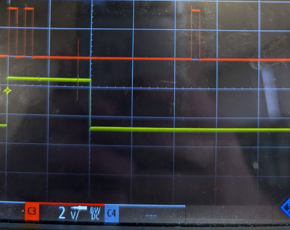

Hi, i managed to achieve 2 pulses!
Now i set TIMA and TIMB as continuos with long period, and i'm trying to reset them with the master at each master period.
The problem is that my master resets TIMER A and TIMER B just after the first period. It looks like it does not take the update of the preload at each sync (i receive it from a pulse by TIM3). Should i force the preload by software each time? it seems crazy to me.
Here you can find my master configuration and my scope results where you can see the two pulses and the third due to the period repetition. That third pulse is not wanted but not a problem, i just want 5 pulses like the first two.
