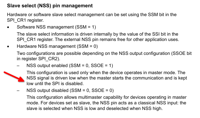

From DS6014:

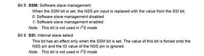

From RM0008:
You're pointing to the SSM and SSI bits, which affect the behavior of NSS in slave mode. In slave mode, NSS is an input. I am using the peripheral in master mode, in which NSS is an output. Furthermore, SSM controls whether the peripheral pays attention to the hardware NSS pin (SSM = 0) or the SSI bit (SSM = 1).

Reading further in RM0008, I see:
I've already encountered some odd behavior in my code where certain callbacks are not being called reliably from the HAL layer. It could be that the code in the HAL layer that disables SPI after a transaction is also not being called reliably. I'm not sure why those calls aren't happening but I suspect some kind of timing or interrupt priority issue with my code, because it changes based on whether I have certain breakpoints set.
If I can figure out why the callbacks aren't getting called, maybe that will also solve my NSS problem.

So the NSS hardware in this chip is just a pin you can set or reset by software, but a real NSS would automatically set and reset the NSS pin on every transfer.
2024-11-04 9:46 AM
@AScha.3 wrote:As I told you: the F10x has no NSS hardware.
Well, it does have the hardware - it just doesn't work in a sensible way!
2024-11-04 9:50 AM
@Imen.D wrote:In hardware mode, the SPI peripheral controls the NSS pin automatically.ut.
But this automatic operation is not what you'd expect (or require) of a normal SPI Master:
@Imen.D wrote:In master mode, the NSS pin can be used to indicate the start and end (sic) of a communication frame..
There's the failure: it does not automatically indicate the end of a communication - see the datasheet extracts from @Brian H and @PGump.1
