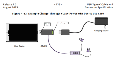

Are there any guides on building the charge-through VPD device with the ST product? An illustration from the standard:
The goal is to maintain the smartphone's supply from the external PD charger while maintaining the connection with a USB 2.0 auxiliary device (specifically, the simple USB CDC device). The auxiliary device consumes <0.1 W.
