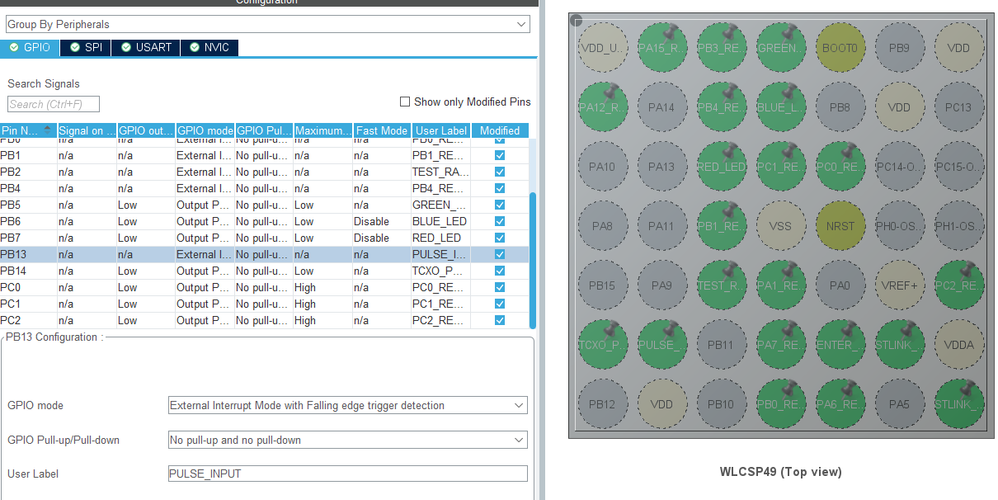

Here is a screenshot of the gpio configuration:
here is the cubeMX configuration function:

/*Configure GPIO pin : PULSE_INPUT_Pin */
GPIO_InitStruct.Pin = PULSE_INPUT_Pin;
GPIO_InitStruct.Mode = GPIO_MODE_IT_FALLING;
HAL_GPIO_Init(PULSE_INPUT_GPIO_Port, &GPIO_InitStruct);

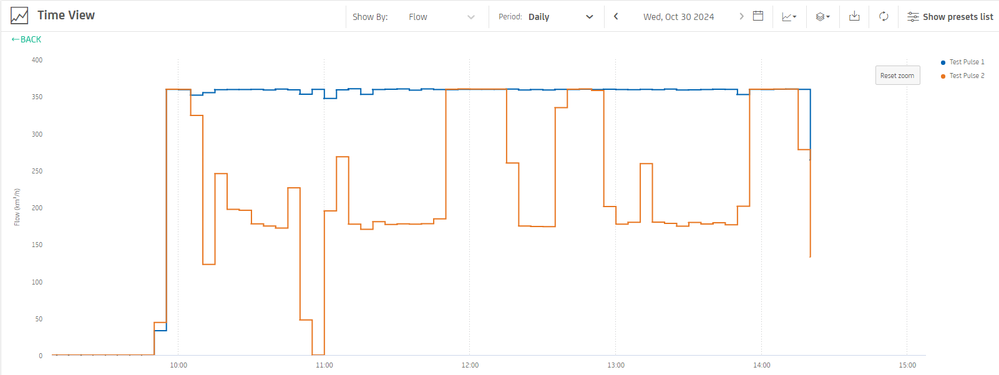

And here is what is showing up on the IoT platform. Sometimes the controller sends the correct 600 pulses, and sometimes it sends 300. The units are not important, as this is only to show if the number of pulses sent match what is sent from the arduino or not. the dip at 11:00 is just from me disconnecting the receiving device for a few minutes.

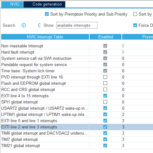

"Is there any other interrupt enabled? If yes, what are their priorities? Try to set the EXTI to be the highest priority interrupt of them all."
I have a couple, but none of them should be firing anywhere near as frequently as the pulse input. here are my callback functions:

lptim has a 1 second period where sTxDelay = 6, the TEST_RANGE_Pin [PB2] is never triggered in this case, and DIO0 [PB4] only goes high if a transmission has been received, which is every 6 seconds, which is a response from the receiving device to verify the sending device's transmission. But to test your hypothesis, I set the interrupt lines to the following:
Unfortunately, I am still only getting half the amount of pulses.
