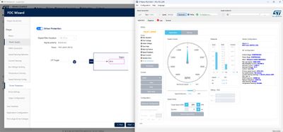

Driver protection error is reported in the MC Pilot interface if feature is enabled:
An associated comment is added in the next MCSDK delivery user manual to describe the error source.

Hello @ClyneModa,
PE15 nFAULT pin is not described in the project (driver protection).
Refer to the STSPIN32G4 datasheet for the nFAULT description and to the EVSPIN32G4 board description for the driver protection feature definition.
You can check if nFAULT is triggered when you start the motor.
