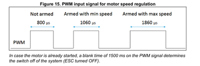

I am not sure if it is Hall sensor based or sensor less. If it is hall sensor then proper placement angle is required. Apart from that the PWM signal what you are providing looks fine. The below diagram is from the user manual.
Maybe you can try disabling UART in case it is loading the CPU, it is just a guess.

thank you for your reply :)
Are you referring to the note under figure 15 in the manual? I had thought that my signals were as the manual instructed, if a 1060us signal arms it with a minimum speed and then other signals within the 1060us to 1860us range adjust speed.
Apologies if that is not what you meant or if I have missed something in this section.
