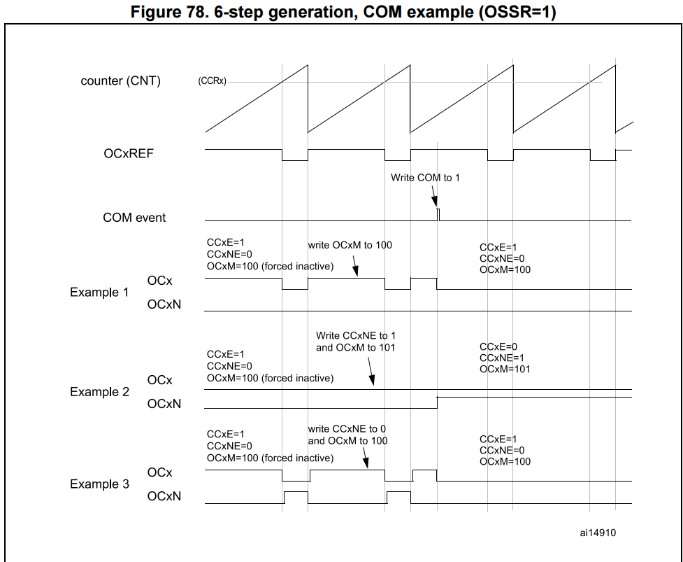

2026-01-13 8:39 AM
Hi there, thanks for your response. I don't that will work because that resets the polarity bits of the CCER register and only would modify the enable/disable bits for the signal output pins. But I found something what might be the cause of still receiving a signal at the pin. In the data sheet for CCER register it's written: "Bit 2 CC1NE: Capture/Compare 1 complementary output enable 0: Off - OC1N is not active. OC1N level is then function of MOE, OSSI, OSSR, OIS1, OIS1N"
