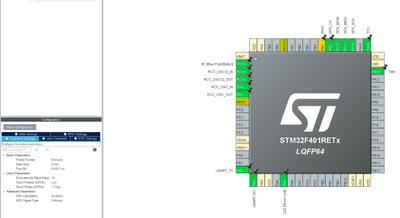

Hello ST expert.
I'm trying to create SPI communication as shown in the CubeMX image.
and the following code

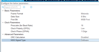

/* SPI3 parameter configuration*/
hspi3.Instance = SPI3;
hspi3.Init.Mode = SPI_MODE_MASTER;
hspi3.Init.Direction = SPI_DIRECTION_2LINES;
hspi3.Init.DataSize = SPI_DATASIZE_8BIT;
hspi3.Init.CLKPolarity = SPI_POLARITY_LOW;
hspi3.Init.CLKPhase = SPI_PHASE_1EDGE;
hspi3.Init.NSS = SPI_NSS_SOFT;
hspi3.Init.BaudRatePrescaler = SPI_BAUDRATEPRESCALER_32;
hspi3.Init.FirstBit = SPI_FIRSTBIT_MSB;
hspi3.Init.TIMode = SPI_TIMODE_DISABLE;
hspi3.Init.CRCCalculation = SPI_CRCCALCULATION_DISABLE;
hspi3.Init.CRCPolynomial = 10;
if (HAL_SPI_Init(&hspi3) != HAL_OK)
Error_Handler();

#endif /* USE_FULL_ASSERT */Normally with the HAL_SPI_TransmitReceive function I should receive on my spi_buf_rx the same thing as spi_buf_tx but instead I receive 255 as shown in the debugging session.
What have I done wrong?
Best regard.

You used the NSS(CS) pin as standard GPIO (Software NSS Signal).
You have to control the NSS(CS) pin by Software.
static void MX_SPI3_Init(void)
hspi3.Init.NSS = SPI_NSS_SOFT; // Software NSS Signal
/*Configure GPIO pin Output Level */
HAL_GPIO_WritePin(SPI3_CS_GPIO_Port, SPI3_CS_Pin, GPIO_PIN_SET); // CS = High
int main(void)
HAL_GPIO_WritePin(SPI3_CS_GPIO_Port, SPI3_CS_Pin, GPIO_PIN_RESET); // CS = Low
HAL_SPI_TransmitReceive(&hspi3, spi_buf_tx, spi_buf_rx, 4, 100);
2024-05-20 5:04 AM
SPI3 is the Master and since NSS is configured as software the SPI module doesn't care about it. The CS signal is only for the Slave's benefit in this case - he'll get a SPI clock and MOSI driven even without a CS assertion.

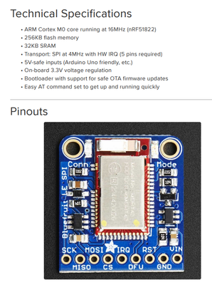

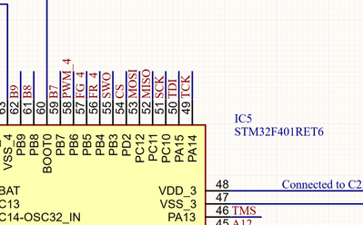

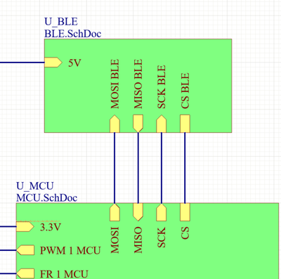

Please find the diagram showing how my BLE module (Adafruit Bluefruit LE SPI Friend) and my MCU are connected.
I need to receive data from the BLE module and send data from the MCU.
I've changed the prescaler to 16, checked the cables and so far I've used the function ‘HAL_SPI_Receive(&hspi3, spi_buf_rx, sizeof(spi_buf_rx), 1000)’ but I still can't receive any data.

Hello Danisgah,
I have followed the debug steps and I still have no communication, I send the number 21 with my android application and I should see it on putty thanks to my uart connection but I am not receiving any data from my SPI.
please find some screenshot and some code

Disconnect MOSI and MISO from the BLE module.
Connect MOSI and MISO at the MCU.
Run your test. You should see the same data received as transmitted. If not, your configuration of the SPI is likely incorrect. If it's the same, disconnect MOSI and MISO from each other and reconnect to the BLE module. Then research the SPI protocol of the BLE module and implement that in your code.
