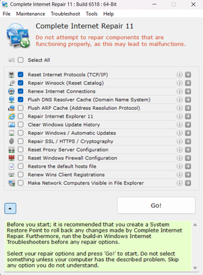

It's FIXED !!!!!!!!
It was indeed a winsock problem and I fixed it by installing a simple app called "complete internet repair" from Rizonesoft.
I selected these options and when it's done I rebootedmy pc and IT WORKED !
Thank you for trying to fix it with me, the winsock hint was very helpful.

2026-04-27 12:33 PM
It's FIXED !!!!!!!!
