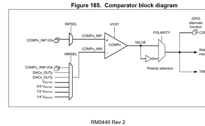

Take a look on figure 168 in reference manual:
https://www.st.com/resource/en/reference_manual/rm0440-stm32g4-series-advanced-armbased-32bit-mcus-stmicroelectronics.pdf
There you can see that comparator negative input can be GPIO, DAC and Vrefint (!) and its fractions (buffered by "scaler"). This Vrefint have nothing to do with VREF used as DAC reference. If you use DAC referenced by 2.048V from VREF (called VREFBUF) with data 0xFFF, then comparator see on its negative input about 2.048V. And it is close to your measure signal. But when you connect comparator input to "Vrefint", then comparator see about 1.2V threshold and it is far from your signal level.
There is no way how to connect comparator to VREF (2.048V) directly. Only way is through DAC. Therefore your claim:
@KHarb.1 wrote:I have a comparator (COMP7) peripheral configured to compare this signal to VREF...
must be wrong. You are probably confused by two different voltage references..
