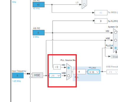

2024-05-22 4:45 AM - edited 2024-05-22 4:46 AM
Looking at your Clock config you seem using HSI as source for the system clock which is not recommended in the CAN communication in Normal mode and you need to use HSE with an external crystal. In loopback mode it works fine. It could be this is the reason of the issue.
So, please check this point before further analysis.
2024-05-22 5:04 PM
I've changed to HSI and nothing changed,as I said it might be a hardware problem from the external ECU.
