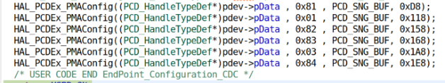

@FBL @isikli Hi, colleagues.
I didn't still solve this. I use standard ST/HAL library.
Board looks OK, because I generated simple HID project and interrupt endpoint data goes ok.
I configure endpoint in my project using
HAL_PCDEx_PMAConfig((PCD_HandleTypeDef*)pdev->pData , 0x84 , PCD_SNG_BUF, 0x150);
and data writes to it by USB_EPStartXfer that calls USB_WritePMA and PCD_SET_EP_TX_CNT.
@isikli USB_WritePMA align/skips data.

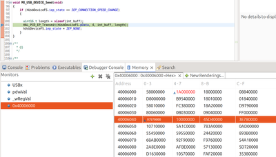

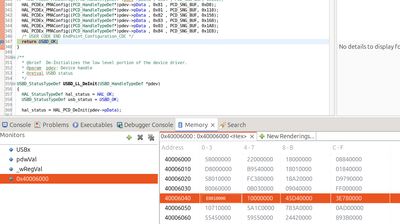

2026-04-16 1:19 AM
@FBL Thank you for your reply
When I just init device it is ok.
As you can see in the picture memory contains correct values
But before sending response memory is curupted
During debugging I didn't found where it could happen.
