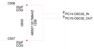

In one of our new PCBs we use a STM32L476VET6. For the RTC we use an external Oscillator (shown in the Picture)
The drive power is set to the highest level.
In our setup, the RTC only works at room temperature and with no probe connected. As soon as the oscillator is heated up to 65°C, it stops working. Same behaviour with the freezer spray. When a Probe for the oscilloscope is connectet to OSC_32_IN, the Oscillator also stops.
We measured the frequency of the oscillator using the MCO-Output on PA8. This way we found out, that the frequency is within the specified range of the oscillator. When using a slightly higher load capacity the frequency drops out of the specified range. When the load capacitence is lowered (we tried 15pF) , the frequency rises higher than the specifiaction of the oscillator. This makes us certain, that the right load-capacitence is used.

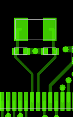

This is the Layout:
Note that there is a gound plane underneath the oscillator and the capacitors.
Don't. Have a dedicated return from the capacitors to the GND (VSS) pin closest to XTAL pins. You can try this by drilling out the via or otherwise disconnecting the common area to which the capacitors are soldered, and patch in a short wire to that GND pin.

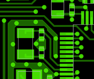

Here is the layout from our older project (using the STM32L4R5ZGT6)
Gnd for the capacitors is also provided using a via to the GND layer. There is not even a GND-shield around the oscillator. Still it is very stable (at least it doesnt stop oscillating when treated with heat or cold).
In the newer project (using the STM32L476VET6) the oscillation just stops when the temperature changes. When an oscilloscope is connected to the OSC32_OUT - pin the peak-peak voltage is approx 200mV. As soon as the oscillator is heated, the voltage starts to decline until it reaches 0 and the oscillator stops.

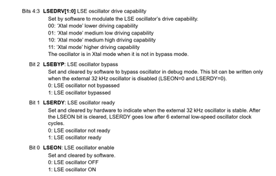

did you check: setting drive level high -> look in (debug, sfr ) whats real setting in rcc lsedrive (in rcc_bdcr).
(iirr Cube set wrong bits for drive level, but i dont remember cube version and cpu type. So just check..to be sure.)
2024-11-18 10:42 PM
We checked, the drive-levle is HIGH with both bits on "1"

I definitively recommend following the layout recommendations of AN2867, especially keeping the ground return from capacitors separate from any other ground and connecting to the nearest VSS pin of the mcu; however, if you're redesigning hardware anyway, you may want to consider using an oscillator instead of plain crystal (by e.g. making space for it in the layout).

Thanks for the reply Jan, we are definitely following your logic. We have redesigned the layout with a ground keep-out under the crystal to minimize stray capacitance and an isolated ground return path to the MCU from the load caps. We also put in a population option for a powered oscillator which we have already prototyped and we have not seen any RTC stops or failures when using the dedicated oscillator. It is more expensive and less efficient to use an external oscillator, but it may be required for proper RTC operation.

I had exactly the same problem few years ago and it was solved successfully. First, there should be no ground or Vdd (or any other signal) plane in ANY layer under the crystal AND its connections to MCU pins. Second, set drive strength to high.
