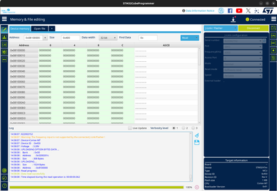

2025-11-27 2:44 PM - edited 2025-11-27 3:03 PM
Hi TDK,
I thought it was resolved by disabling an ISR, as it worked 1 time. But now appears to fail again
I check memory in cortex-debug memory view and STLINK
if I step through the code memory appears to erase and write correctly in cortex-debug. But when I disconnect and open STLINK it reads all 0x00000000 (I'm erasing sector 0 in bank 2)
But I am starting to think it's just STLINK failing to read for some reason as when I restart and read out the memory in code it appears to be correct.
