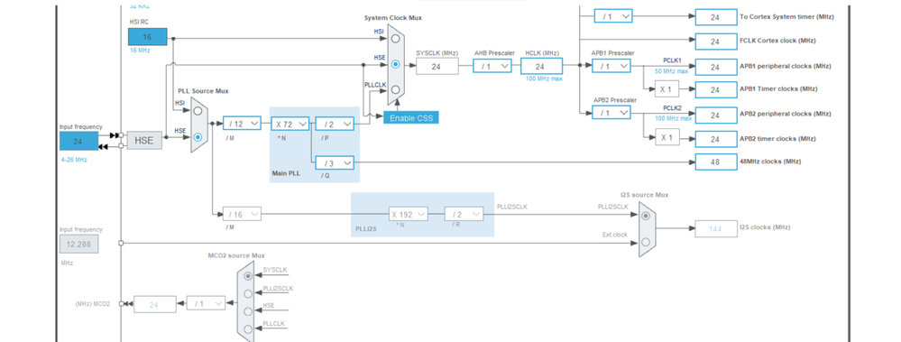

I went through other posts on this forum. I made sure interrupts were enabled, that the clock is exactly 48 Hz, and I allocated extra space on the heap and the stack.
Here is a picture of my clock.

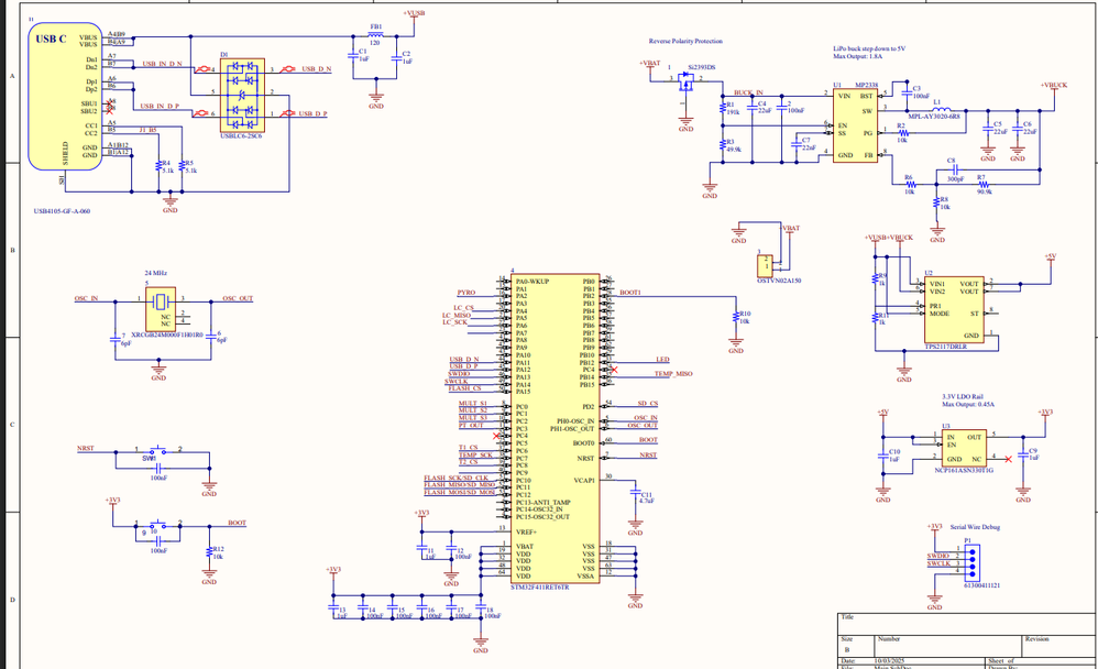

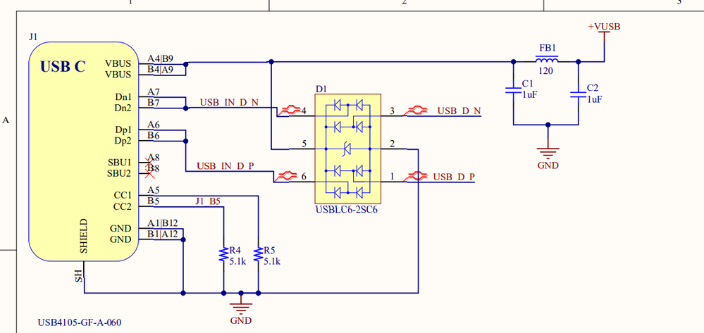

Here is my USB schematic.

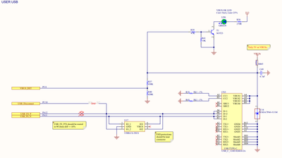

Here is a reference design example :

Yes, you are missing one obvious thing: at least according to the schematic there is no connection between the USB-C connector data lines and MCU's USB data lines.
Also, if you use breakpoints and single-stepping during USB enumeration, the enumeration process will fail.
You don't need VBUS sensing but if not connected, it must be disabled in USB peripheral settings.

I don't see how you can debug hardware without access to that hardware.
Schematic is fine, should work, but clearly something is wrong. That is one way to start the debugging process to identify the issue.
