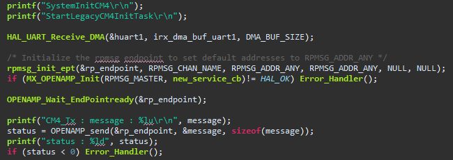

In the functions rpmsg_init_ept and OPENAMP_create_endpoint, if dest_addr and addr are equal to RPMSG_ADDR_ANY(0xFFFF FFFF), I know that the address is automatically assigned to the parameters. is it correct?
just I try to above method, but the address is not automatically assigend to parameters, and the function OPENAMP_Wait_EndPointready fails.

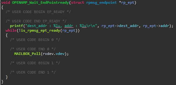

# OpenAMP communication mode : master CM4
# In the function OPENAMP_Wait_EndPointready
# CM4 terminal results
