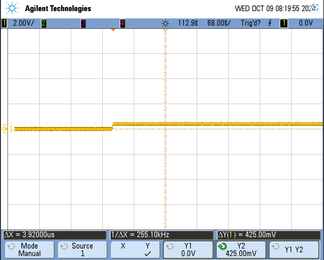

We are observing a tristate on MISO line. To investigate we isolated the uC and checked the MISO line. It is having a voltage level of around 0.4V. Ideally it should be pulled up as we have connected 46.4k pullup resistor on MISO line.
SPI MISO signal image when external IC is isolated from uC.

Is STM32 master or slave?
If it's master, MISO is input, i.e. STM32 does not drive MISO pin and it's the external circuit which should drive it, if selected.

I believe the tri-state is happening from uC side only. Because when we isolate th uC and check the MISO line, it is showing 0.4V.
