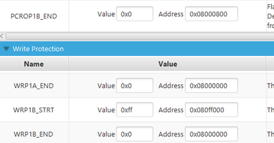

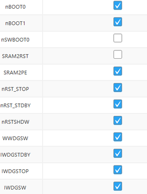

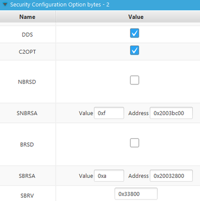

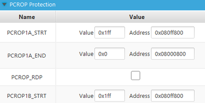

These are my option bytes:

Which version of STM32CubeProgrammer tool are you using?  Which version of the STM32CubeWB firmware package?  Make sure to use the latest releases of used softwares and tools.
Please have a look at this wiki page which describes how to upgrade BLE stack and FUS.
Try using the binary:
STM32CubeWB/Projects/STM32WB_Copro_Wireless_Binaries/STM32WB5x/stm32wb5x_FUS_fw.bin at master · STMicroelectronics/STM32CubeWB · GitHub
