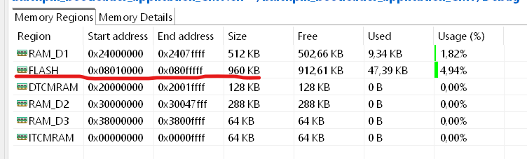

I'm developing the bootloader for the STM32H755 microcontroller from a specific flash memory address of 0x08010000. I also modified the USER_VECT_TAB_ADDRESS definition in the file 'system_stm32h7xx_dualcore_boot_cm4_cm7.c', as follows:

When the software starts, it starts correctly from address 0x08010000, as per the following build analyzer analysis.
But when I press reset and then call the function HAL_NVIC_SystemReset(), it doesn't restart. I'm afraid it won't restart from address 0x08010000, I'm afraid I've incorrectly defined USER_VECT_TAB_ADDRESS. What's wrong and what else is missing to make resetting and rebooting from work correctly?

Are option bytes set up so that core boots to that address? You will need to change them with STM32CubeProgrammer or similar.
> #define FLASH_BANK1_BASE 0x08010000U
This is not correct. Bank 1 starts at 0x08000000.
