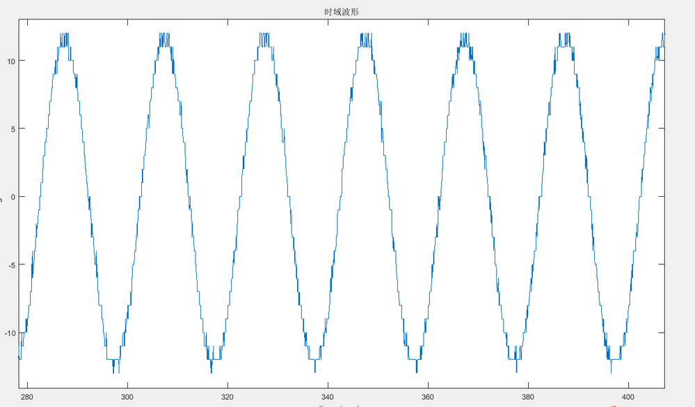

when only run ADC3,ADC3's waveform is normal.

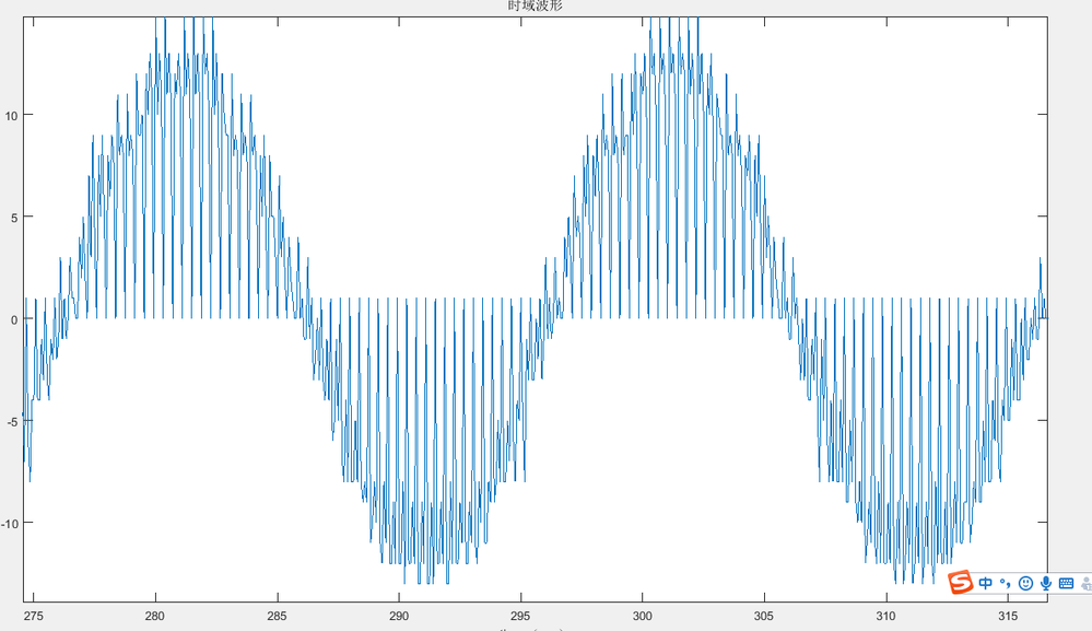

Time-domain waveform of ADC3(only ADC3 sample)
Time-domain waveform of ADC3(ADC3 and ADC1 sample together)

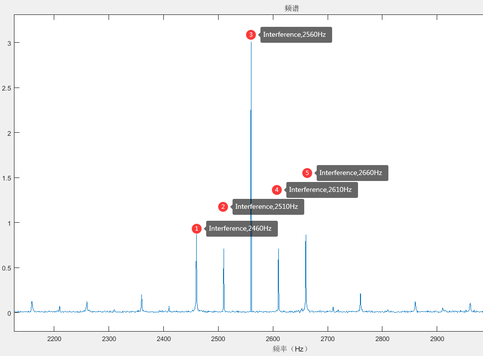

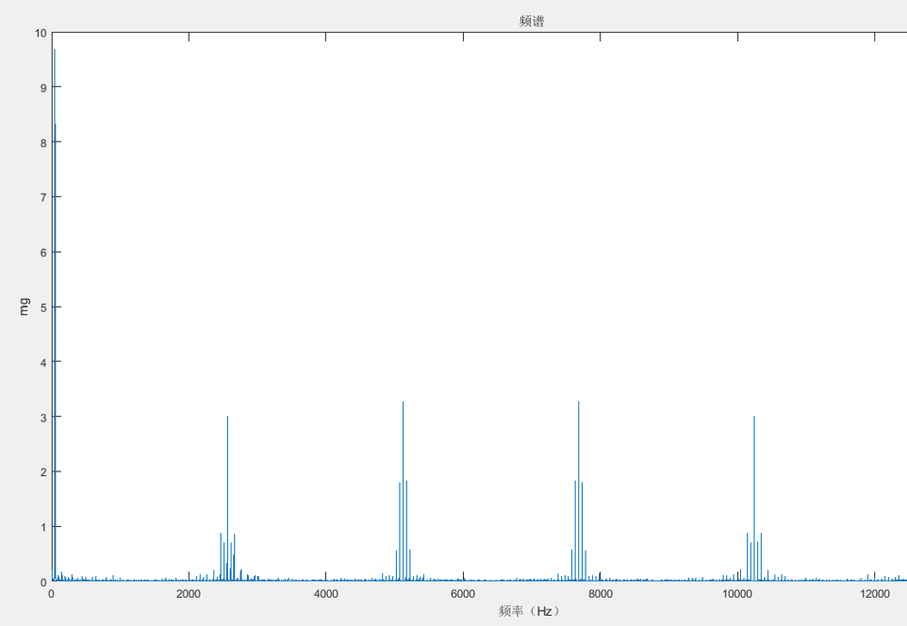

Frequency spectrum waveform of ADC3(ADC3 and ADC1 sample together).
The follow picture is Enlarged view.(ADC3 and ADC1 sample together)

Interference signal. The same of other three. Interval of frequency is 2560Hz

The second image clearly shows that every n-th positive sample is 0 and every n-th negative sample is 1, which is probably because of some off-by-one processing error. Therefore look for wrong buffer address/size and flaws in processing code.
