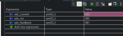

I am just wondering how it is possible that 3 adc gave me the very same value, if I change the channel and their rank are different.

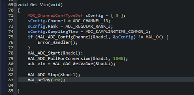

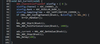

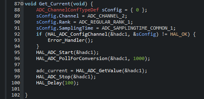

When converting a single channel in fully configurable mode, rank 1 is the only channel converted.
Two of your three pictures are the same. The other one configures rank 3 which isn't converted.

Almost the same value...

I was just wondering... If an adc is burned inside a stm32g051g8, should all the values that the ADC from different channel be the same or quite similar?
