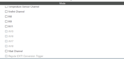

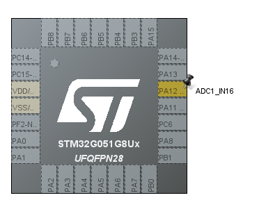

I begin a new project I want to use the PA12 as a ADC input. But the pin is orange and I am unable to activate the mode or channel of the ADC.
What is the explanation behind it? How do you explain it?

There is a trick, see Solved: STM32G030K6T6 - can not configure ADC1_IN16 @ PA12 - STMicroelectronics Community
enable ADC IN0 temporarily.
change sequencer settings in ADC parameters tab,
enable ADC1_IN16 on PA12
disable ADC IN0
hth

2025-03-20 4:12 AM
It worked.
