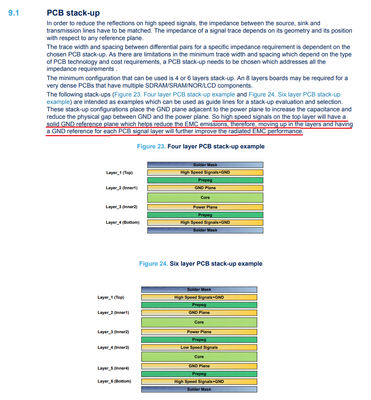

AN5419 "Recommended PCB routing guidelines for STM32H723/733, STM32H725/735 and STM32H730 microcontrollers" / section "99.1 PCB stack-up" (applies also to STM32H743) suggests "the minimum configuration that can be used is 4 or 6 layers stack-up. An 8 layers boards may be required for a
very dense PCBs that have multiple SDRAM/SRAM/NOR/LCD components."
