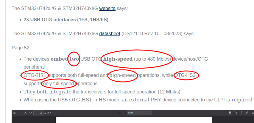

The STM32H742xI/G & STM32H743xI/G website says:

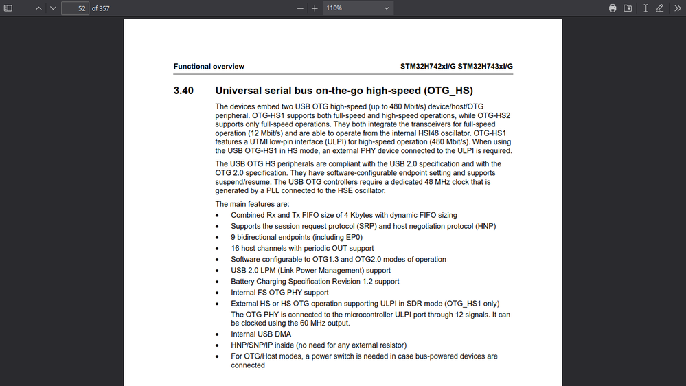

The STM32H742xI/G & STM32H743xI/G datasheet (DS12110 Rev 10 - 03/2023) says:
Page 52:

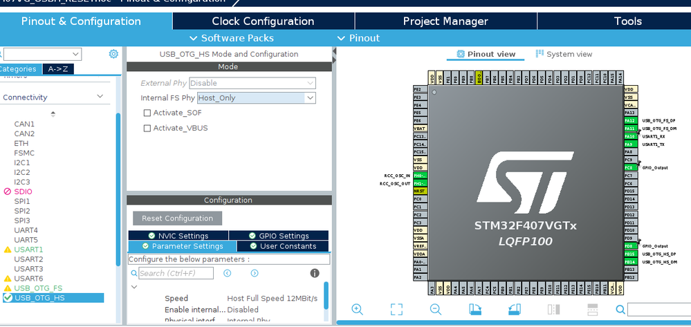

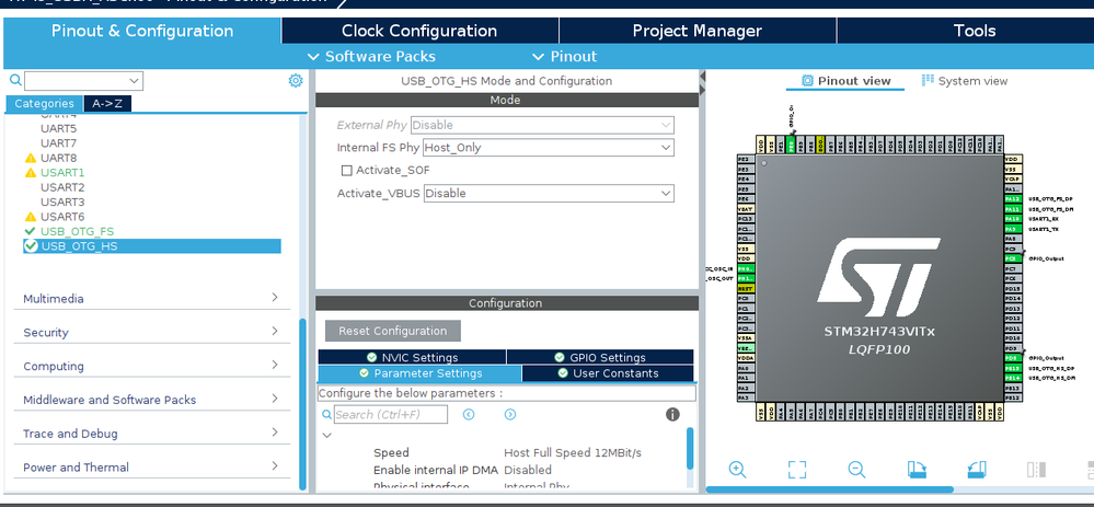

The STM32CubeIDE shows pretty much the same settings for the H743 MCU as it does for the F407:

...and where is the error now ?
that all H7 need external driver (phy) for hi-speed ?
thats a feature, not a bug. :)
(only F723 has hi-speed driver built in , afaik )
ds say, there is hi and full speed usb module (on some H7) ; full speed has internal phy, hi speed needs external phy.
again:
ed.
ah, i see: on p.52 >two usb hi-speed ..< . thats wrong, ok. should be : >two usb hi- or full-speed ..<
2023-06-18 4:53 AM
The OTG markings are notoriously inconsistent throughout ST's documentation, they differ even within documents to one model.
I am not defending it, it's bad, and in this particular case it's incorrect.
I call "HS USB capable only of FS" a marketing lie.
