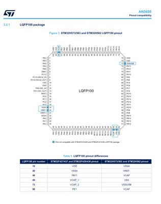

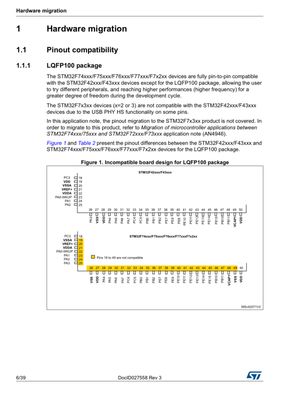

Dear @RhSilicon ,
Indeed LQFP100 is the only package not pin-to-pin compatible with STM32F7 series due to optimized performances and sustain the power rails . Here is attached screenshots from our Application note of Migration
by the way , why moving to F7 or H7 series - curious to know if you need more memories or performance .

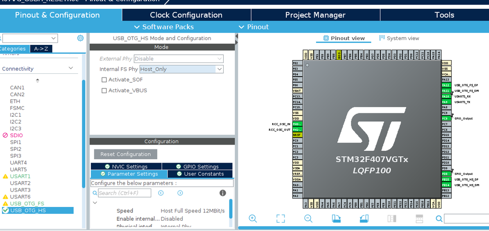

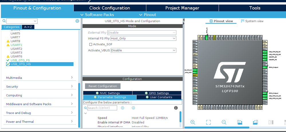

Thanks for the information, just to confirm, do all products that have internal Full-Speed (FS) USB OTG PHY have the same silicon lithography design on the PHY module? Including the H7 line?
I ask this because I was thinking of making a new PCB board using MCU H743, but if the internal FS USB OTG PHY of H743 is the same as that of F407, then I will try to work around some problem locally
H743:
F407:
I recently learned that the H743 has a Y and V revision. Is there any possibility that there is a revision in the silicon lithography of the internal USB OTG PHY Full-Speed (FS) PHY, which allows for greater robustness?
