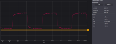

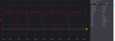

2023-06-18 2:14 AM - edited 2023-06-18 3:18 AM
But does the way I measured ADC runtime is fine? there is a better/accurate way? like system clock cycles?
I tried, so with ADC I got the following result (GPIO4 connected to scope -1.287uSec)
and with only set/reset command give me (343nSec):
So I got 1287 - 343 = ~900nSec = 0.9uSec, still twice then datasheet
How can I reduce it?
