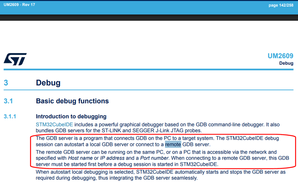

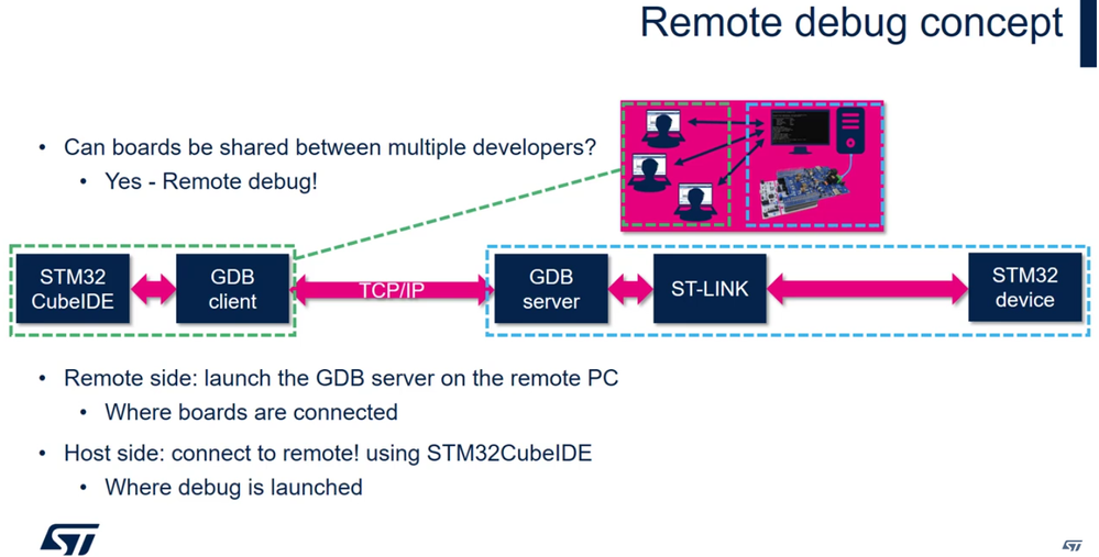

This is the recommended way to do remote debugging:
https://www.youtube.com/watch?v=Xw5ojR2Ygcw
See also:
2026-04-28 4:57 AM - edited 2026-04-28 4:57 AM
See also:

2026-04-28 6:31 AM
Looks like OpenOCD works the same:
https://openocd.org/doc/html/GDB-and-OpenOCD.html
https://linuxjedi.co.uk/remote-programming-and-debugging-stm32s/
