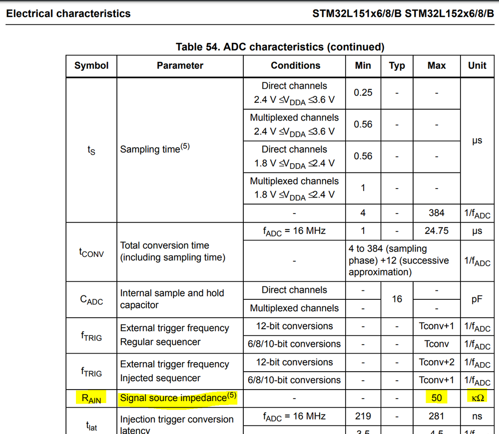

TDK,
IMO DGian.1 is looking for the resistance of the MUX switch.
2020-08-12 6:34 AM
You are likely correct, as usual. Value is probably 6 kOhm as in other families but agreed it's not in the datasheet.
2020-08-12 6:43 AM
Yes, I'm looking the internal resistance value of the MUX switch (R_ADC not R_AIN). But I also assume it is 6kOhm as in the datasheet of STM32F405.
