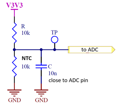

This is what TDK means - although the capacitor seems to be debatable.
I actually use a H7 ADC for voltage monitoring with many muxed inputs, each input has a divider like that, always with 10k || 10 nF to GND. But with low ADC clock and big sampling times.

2025-09-29 12:12 AM
> I do not recommend a capacitor here.
I'd rather use a long sampling time and a capacitor for each input.
Even though this slowly changing input signal can easily be filtered digitally, but still there's noise to suppress - and in this case maybe even from inside ADC to the outside. I haven't seen that (haven't checked) for the STM32, but with other ADCs.
2025-09-29 12:19 AM
