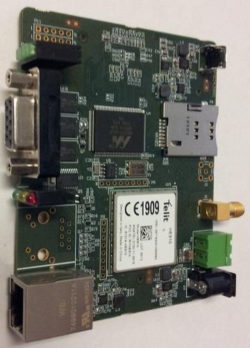

Embedded Linux boards are coming down, you just have to look at things like the Raspberry Pi, Beagle, Galileo.
If you need a lot of USART you could consider satellite STM32 (low cost, small memory ones) to consolidate multiple serial streams, or implement something like CMUX Doing the USB stuff you propose on the STM32 will be a nightmare. It has very limited end-point support, and aimed at much simpler solutions. The prospects of supporting a generic hub (single chip multi-port), and available open source drivers in Linux is a lot more promising.2014-08-29 9:26 AM

Hello Clive: what type of board is that? (manuf / pn?). Thank you.
2014-09-02 7:45 AM
http://www.janus-rc.com/Documentation/JA17-PB_Terminus_Cend.pdf
400 MHz ARM9, 128 MB DDR3, 48 MB SPI FLASH, 1x or 2x 10/100 ETHERNET I also have other devices usinghttp://www.janus-rc.com/T2Terminus.html
, and more recently STM32F4 (1MB, and 2MB capable) using ahttp://www.janus-rc.com/terminuscf.html
.2014-09-02 8:46 AM
