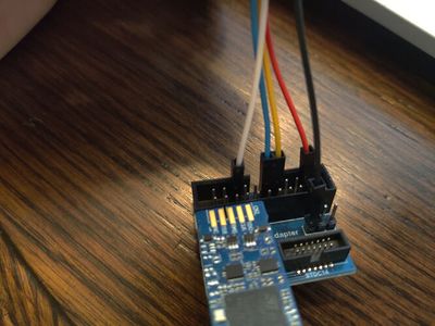

I bought an STlink V3mini from Waveshare. There is not a datasheet available from waveshare.

The ST link is also brand new. never used. I have tried the usb cable that came with the st link, and also a known good one that I have used for programming arduinos on the past.

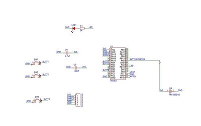

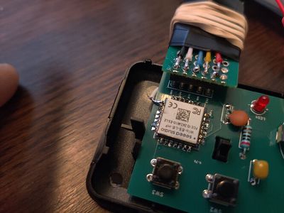

The project is this: I wanted to make a long distance (a few hundred feet) remote control for my gate operator. This is the transmitter part. I designed a pcb that fits into a housing I already have. I also made a small pogo pin clamp that clamps to my programming header pin.

Edited again: I found this “The LED is red: an overcurrent is detected on the board and the target power is switched off automatically (overcurrent protection). The cause of the overcurrent must be investigated, or the board must be connected to a more powerful USB port.” in the datasheet. The LED DOES stay red. I tested the resistance between + and gnd and get over 10M ohms, so I did not think there was a short anywhere.
