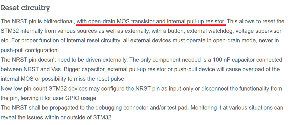

Although the Datasheet and Reference manual do not explicitly disclose the internal circuit diagram of the NRST pin used during NVIC_SystemReset, I found information in the community stating that NRST internally has an "Open-drain" structure.
link : https://community.st.com/t5/stm32-mcus/why-my-stm32-doesn-t-start/ta-p/49367

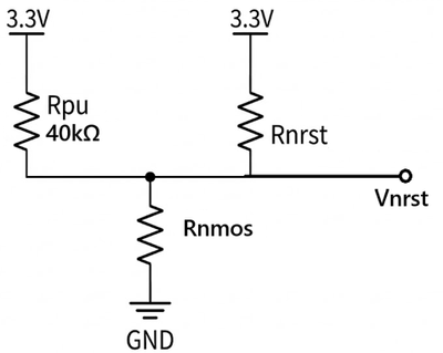

Therefore, I assume the circuit topology is as follows:
My understanding of the operation is as follows:
When the NMOS turns ON, it will appear as a resistor due to its internal resistance (Rnmos).
During the reset drive, the voltage at the NRST pin will be divided as follows:
The equivalent resistance of the parallel pull-up resistors is:
If Rnrst is much smaller than Rpu, Rtotal will effectively be seen as Rnrst (the external pull-up we attached).
If we consider a case where Rnmos is equal to Rtotal, then Vnrst would be 1.65V, which is far above the VIL threshold.
Consequently, NVIC_SystemReset would not function correctly.

We attached a 10 kΩ resistor, and we confirmed that the reset works well during NVIC_SystemReset.
However, I am concerned whether the reset might fail during actual system operation, especially since the community mentions not to drive the voltage externally.

This is still a common misconception, the origins of which date back to the last millennium when external pull-ups were connected to reset pins of ancient microcontrollers (the pensioners among us still remember: aaah, back then...). An external pull-up is NOT necessary, as you yourself have deduced from the internal pull-up. This renders any discussion about levels and potentially poor Rnmos obsolete.
Does it answer your question?

Thanks for the clarification. I agree an external pull-up is not required for a new design.
In our case, the boards are already manufactured with a 10 kΩ pull-up to 3.3 V on NRST.
I cannot easily remove them at this stage.
Could you please confirm one of the following:
Is 10 kΩ considered an acceptable external pull-up value for NRST on STM32H563?
If there is any official guidance, what is the minimum recommended (or prohibited) range for an external pull-up on NRST?
(We couldn’t find NRST VOL/IOL or sink capability specs in the datasheet.)
We have verified that NVIC_SystemReset() works with 10 kΩ, but we want to ensure there is no corner-case risk.

2026-02-06 7:46 AM
There are a massive amount of people out there designing their boards with an external 10 kOhm pullup on
NRST. While unnecessary, it has never been an issue. The board will be fine.
