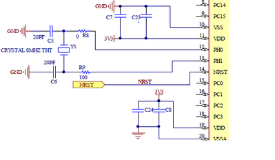

Your calculation is generally correct, and HSE should work on the lab bench, although the values for CL1 and CL2 are a little too large. You should also consider the board and pin capacitance and dimension CL1 and CL2 to 12...15pF, for example.
However, you have only shown a section of the schematics:
Regards
/Peter
2024-03-01 2:43 AM
Please find answer
VDDA is tied to VDD

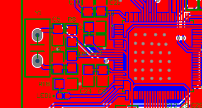

2024-03-01 3:50 AM
uC oritentation is correct as LED blinking program is working using HSI. I changed CL1 and CL2 but same situation. I am yet to try with lower CL values.
Pls find the pcb layout.
2024-03-01 4:18 AM
Well, the layout is an example of how not to build it:
BTW: NRST does not require a pull-up as it is already installed (see RM0090, section 6.1.2). Yes, I know that a pull-up can sometimes be found, e.g. with the Blue Pills from Asian suppliers - which is still not correct.
Finally: are you also 100% sure that the HSE has been activated?
Not that you accidentally selected a different clock source on the DISCOVERY?
