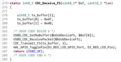

I'm working on an interface board based on STM32F412 to send CAN frame from a computer using USB communication.
For the moment I'm doing some tests with the CDC stack and the default ST's USB virtual com port driver on Windows 10. My test software is simple, when I receive something from the USB, I send 'OK' to the host. I do nothing more.
