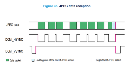

DCMI_HSYNC is used to signal the start/end of a packet. DCMI_VSYNC is used to signal the start/end of the
stream. If the full data stream finishes and the detection of an end-of-stream does not occur (DCMI_VSYNC does not
change), the DCMI pads out the end-of-frame by inserting zeros: if the stream size is not a multiple of four, at
the end of the stream, the DCMI pads the remaining data with zeros.
For that, I advise you to check the DCMI_HSYNC and the DCMI_VSYNC parameters which are responsible for start/end of packet and stream respectively.
Note that in snapshot mode, once the first complete frame is received, the DCMI is automatically disabled (CAPTURE bit automatically cleared), and all the other frames are ignored. In case of an overrun, the frame is lost and the camera interface is disabled.
I think 8.3.7 JPEG data capture example in AN5020 can help you.
