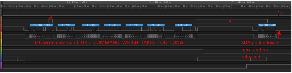

This timing snapshot shows the issue:
Point A: This is a trace on HAL_I2C_AddrCallback()
Point B: This is a trace on doSomethingWhichTakes50us() which causes the next I2C transmission to be missed
Point C: This is a trace on HAL_I2C_ListenCpltCallback() which calls HAL_I2C_EnableListen_IT() fractionally too late
Does anyone have any ideas on why this is happening, and how to get out of a sticky situation like this? How can I detect that this has even happened on the STM?
