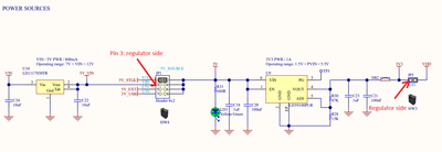

In which condition you did measure the resistivity on JP5?: the board is powered on? you should measure the resistivity with the board completely pored of: need to disconnect all the stuff from it: all the external cables and wiring. If you find 2 ohm on JP5, unfortunately there is something broken on the board.
To find what happened to your board:
1- Test U10: the 5V regulator. Remove JP1 and connect VIN between 7 to 12V max and find if you have 5V on JP1 pin 3 like indicated in the above image. If 5 volt is available, U10 chip is OK.
2- Test U9: the 3.3V regulator. If U10 is OK, put JP1 on position 3-4 to select the external source over VIN as power source and remove JP5. Do you get 3.3V? on the regulator side as indicated in the above photo? If yes, I can suspect the MCU is gone.. You can confirm that by removing JP5 and test the resistivity on JP5 pin / MCU side. if it's very low, the MCU is broken..
